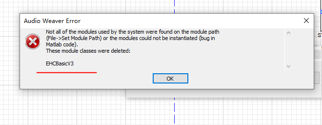

When trying to import an awd file, a dialog box error as shown in the figure below pops up.
How to solve this problem?
Is it an environment installation problem? Thank you very much.

Hello Alfec,
It's possible this design contains a module that is not included by default with Designer, and is part of a separate module pack. By chance did your company receive a particular build of Audio Weaver with specific libraries at some point? If you received a or created a module pack containing EHCBasic separately, you can add it's .dll to the Bin/win32-vc142-rel, then in Designer choose File->Set module path to add the folder containing the module files. This would allow it to show up in your module browser.
