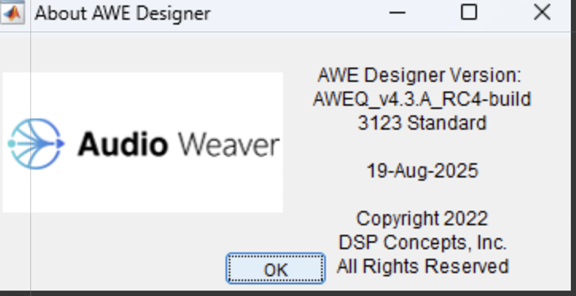

9:35pm
The AWE designer version please refer to the attachment.
