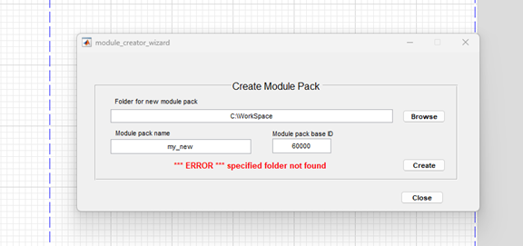

it occurs "ERROR specified folder not fond" when i generate customer module with AWE 4.3 version.
it works fine with AWE 3.1 version.
please refer to the error tips in the attachment. how to fix this issue ?
I hope to get your help.
Thanks.
Thanks.

Hi Yong Li,
This is a bug in: AWE_Designer_AWEQ_v4.3.A_RC4-build3123_Pro.
It has been resolved in: AWE_Designer_AWEQ_v4.3.A_RC4-build3259_Pro.
Please update your AWE Designer package and let me know if you continue to face any issue.
Thanks,
Gary
10:07pm
It works fine.
Thanks for your support.
