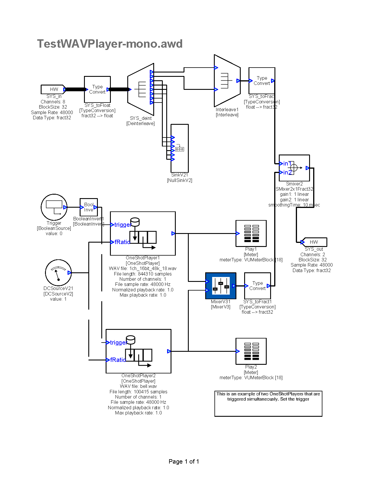

HI Andrew, I wanted to make a test jig using WAV players modules as proof of performance, and which will be the audio source for more complex processing tasks. For example, in the layout below, I'm using two oneshot players mixed with a Line Input, to test different sampling rates, channels and bit depths.
