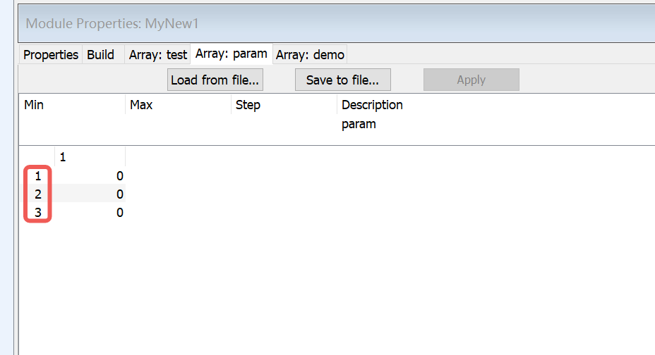

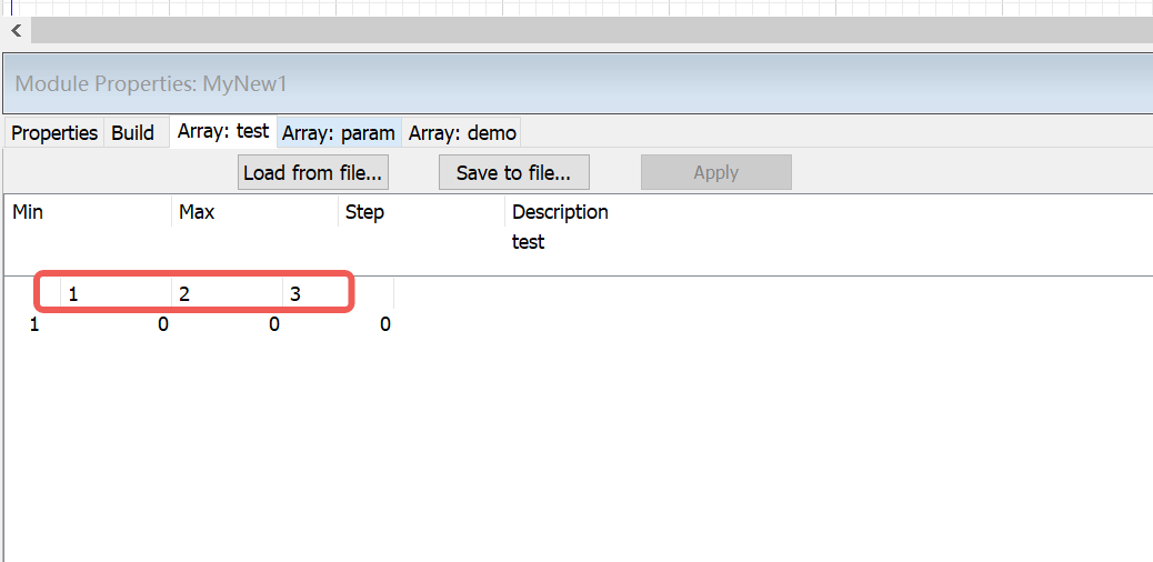

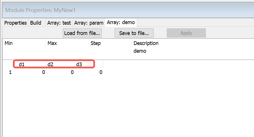

But only the three horizontal labels in the demo are displayed normally

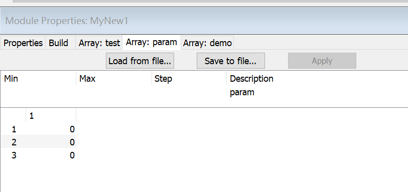

Thank you for your reply. I have modified the code as follows, but it still cannot display vertical labels and multi-page labels. It can only display horizontal labels on the last page.
