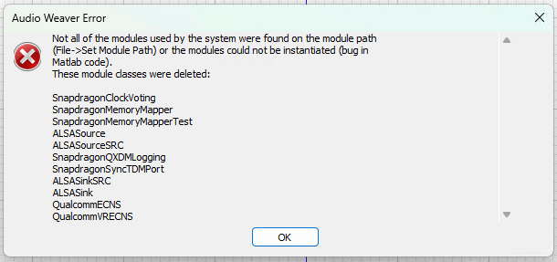

I'm using AWE Designer 8.2025.2.A_Standard. When I open an example then I see below errors
Then I check and don't see AlsaSource and Snapdragon Sink modules at all in this version
Could you please check which version I should use to have those ?

Hi Minh,
You will need a special version of Audio Weaver to work with AWE-Q for the time being. What is your version of AWE-Q?
