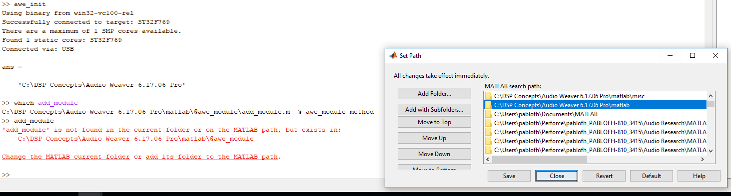

Hi Axel,
Thank you for your reply.
As you can see from the picture the path is set, the "which" command works, but for some reason I cannot run the commands in @awe_module. I am puzzled.
Pablo

Hi Axel,
I looks like my way of testing was wrong. If I run any of the modules in @awe_module alone, as in the picture above, then I get the error message, but if run them including input parameters, like in your test script, then it works.
We are back on track. Thanks for your help.
KR, Pablo
