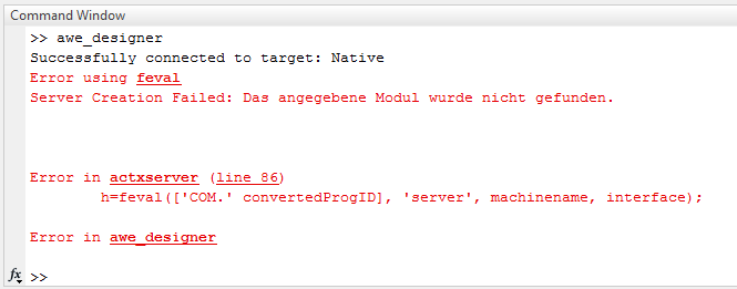

After running the matlab line awe_designer following errors are shown and the GUI doesn't work.
This behavior comes from nowhere; for one year everything runs fine.
System: Win 7 64 Bit, Audio Weaver 5.16.B04 Developer
The newest AWE Version is no alternative, because for me only Matlab 2015b is available.
Version 6.18.xx Pro seems not to work with the available license (already tried this).
Thanks Max
Axel Nilsson
Offline
Last seen: 1 day 6 hours ago
Joined: 12/19/2016 - 2:02pm
Hi Max,
I think you have run into an issue with the registration of some of the Audio Weaver .dll's. Please see this post for the steps that should fix your issue: https://dspconcepts.com/forums/audio-weaver-designer/418-server-creation...
Let me know if the problem persists after you re-register the .dll's.
-Axel
Max
Offline
Last seen: 6 months 3 weeks ago
Joined: 10/23/2017 - 10:14am
Good Morning Axel,
Nice, this steps fixed it.
Thanks a lot!!
